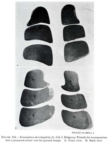

"a. The vest and its metal plates are designed in a larger size than the Japanese. The plates were hammered out of steel from plaster casts moulded on a soldier 5'7" in height weighing 150 pounds. These plates should fit all soldiers except those of an extremely small or large stature. (A marking of "medium" in Japanese characters on one of their vests indicates that they are manufacturing them in more than one size.)
b. The space at the base of the neck just above the breast bone and the region of the large blood vessels just beneath the collar bones are covered in the new design.
c. Better metal protection is given the flanks and the lower part of the abdomen.
d. A metal plate is added on the inside of the back of the vest to cover the base of the spine and the kidney areas.
e. The button arrangement of fastening the vest down the front has been eliminated because it takes too long to discard the vest by this method. The front of the vest should be in one piece. The vest should be fastened by one or two clasps along the left side of the chest and flank, and by a clasp on each broad shoulder strap of the vest. These last two clasps should be arranged sufficiently low on the shoulder so as not to be pressed on by the rifle when carried on the shoulder or by the butt of the rifle when firing. By this arrangement the vest can quickly be discarded in any direction even with overlying cartridge belts, etc.
f. A small curved strip of metal should be incorporated into each shoulder strap to help prevent the wounds incurred by missiles entering the chest through the space above the collar bones, when a man is charging with the upper part of the body bent forward.
g. In soldiers or sailors in stationary positions, where extra weight is not so important, such as crews of antiaircraft guns, additional metal plates could be added to protect the back and shoulders from gun fire."
    28.6 KB · Просмотры: 331

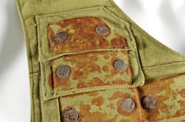

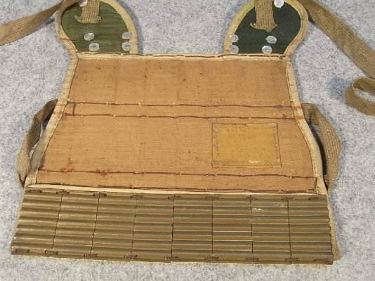

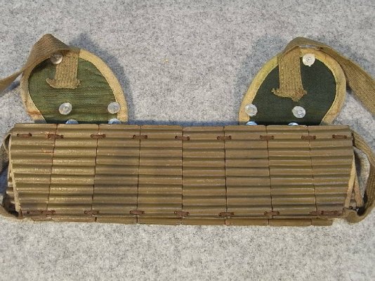

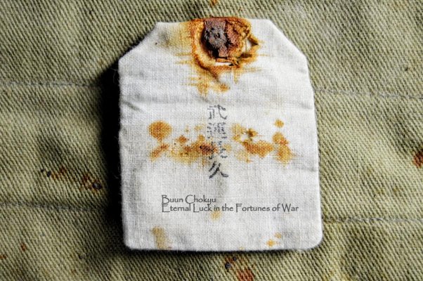

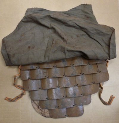

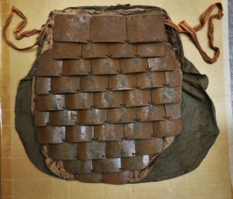

А вот крайне любопытный спесимен, что на днях показал наш американский коллега :wink3:
Судя по "реверсу" своему владельцу он помочь не смог :blush2:
    85.8 KB · Просмотры: 379
    62.6 KB · Просмотры: 381

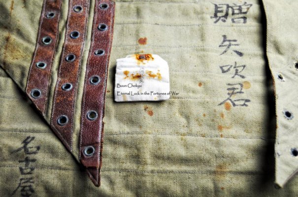

Технология! :cools:
    167.3 KB · Просмотры: 338

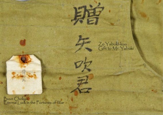

Весь расписной.
В подарочно-памятных-пожелательных надписях.
    108.7 KB · Просмотры: 385
:rolleyes:

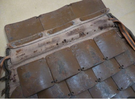

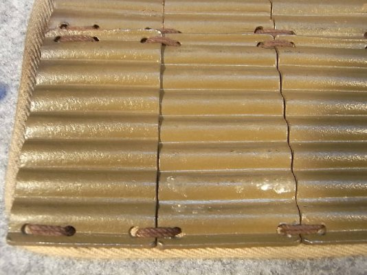

У Артура Таекхара есть подобный броник .
Добавим еще такой .
    47.2 KB · Просмотры: 326
    46.8 KB · Просмотры: 334
2.
    37.3 KB · Просмотры: 338
    108.2 KB · Просмотры: 357
    97.4 KB · Просмотры: 336
Был еще такой вариант
    149.6 KB · Просмотры: 333
    127.5 KB · Просмотры: 335
2.
    113.4 KB · Просмотры: 336
    165.6 KB · Просмотры: 313
    172.7 KB · Просмотры: 344
